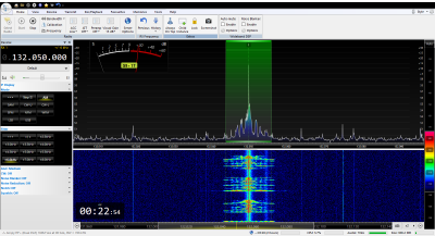

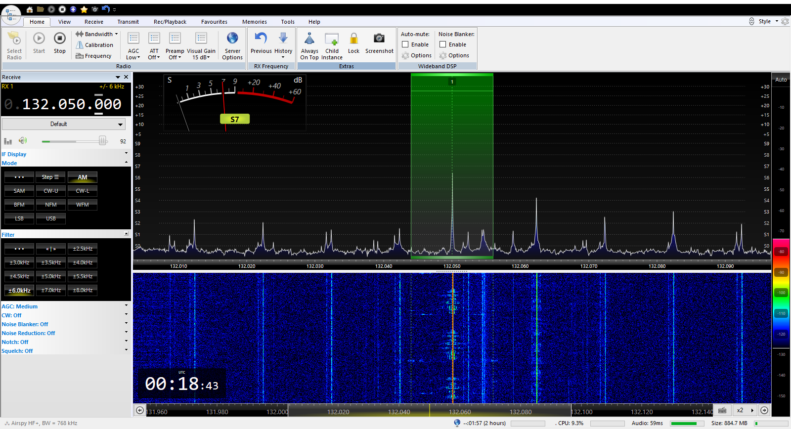

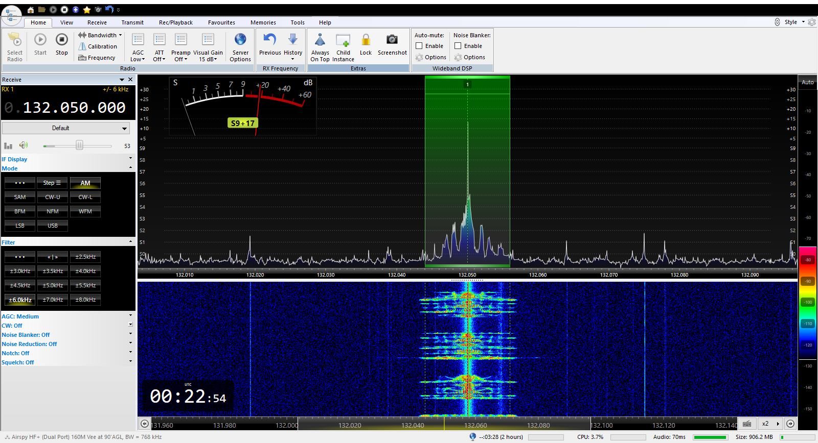

Attached images show the difference in signals (and QRM) via the Airspy HF 2 port on the two different antennas/locations, while monitoring 132.050MHz, Pease Tradeport ATIS at 13.5miles to the NNE. The clear winner is Super Station #4 due to it's height on a tower, almost line of sight if it wasn't for the tall pine trees 500' north of me.
I have a suspicion that the ADSB server running in attic on a Raspberry Pi via Ethernet connection is causing the QRM on Station #1 & #3 VHF since the antenna is ~25 feet away. You can clearly see how weak the ATIS is and the numerous vertical QRM lines.

Thanks for the update. Nice VHF signals on Super Station #4. I agree, there is a lot more QRM in the attic. I would lose sleep at night wondering how to choke off that noise. But, that's just my inherent air traffic controller personality CDO kicking in. (CDO is the same thing as OCD, except that the letters are now in the correct order.) :=)
