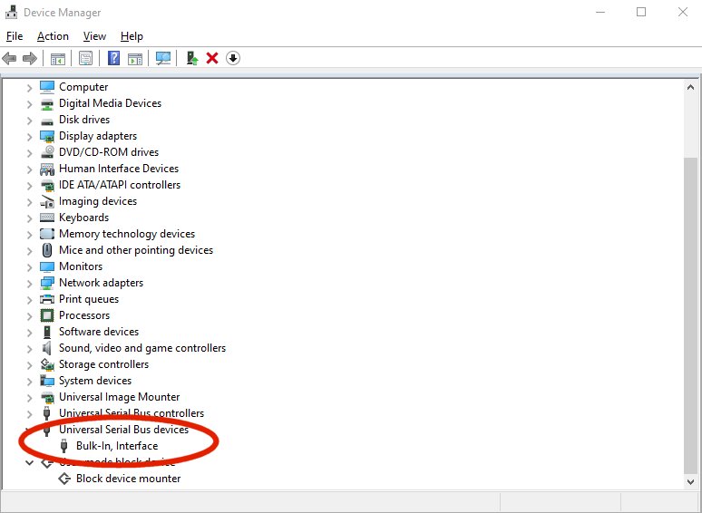

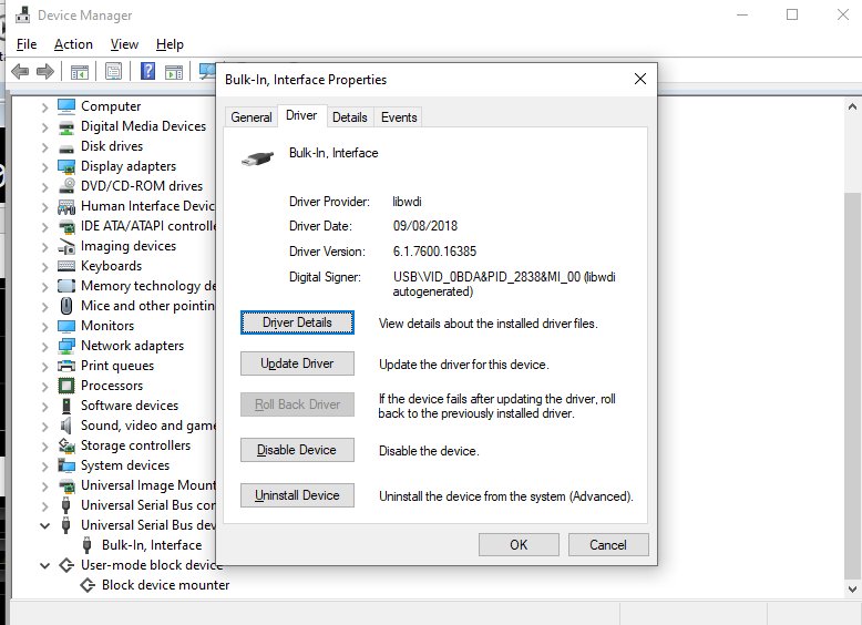

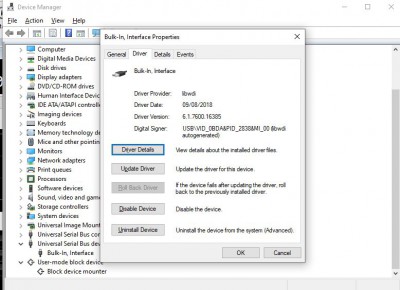

I have just updated my laptop to Windows10 and now SDR Radio no longer finds the RTL dongle (R820T2).
I have re-run Zadig 2.5 and re-set the 'Bulk in, Interface (interface 0)' driver to WinUSB (v6.1.7600.16385) but SDR console is still not linking to the dongle and receiving signals.
Device manager has the dongle listed under Universal Serial Bus devices as Bulk-In, Interface.
Two files attached show the Device Manager listing and the driver details if that is of any help.
It did all work before the OS update to Win10 from Win7.
Anyone have any ideas that I can try?
Richard

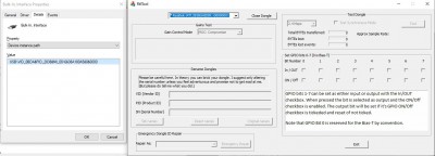

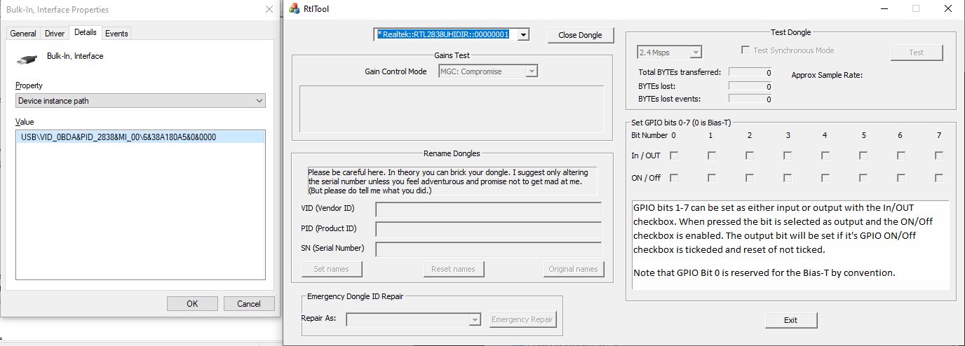

Please promise not to try some of the fancier features such as renaming the dongle, for the present time. My RTLTool.exe can help you determine if a dongle is present and recognized. Unzip it. Run it from where you unzipped it. It SHOULD find your dongle and allow you to test transfers at various data rates. If RTLTool, which is quite lightweight, cannot find the dongle then more work will be required to see what went foobar.
You could right click on the device in Device Manager, select properties, select the details tab, and get some readouts. What does it say for the "Device instance path", the second item in the "Property" droplist?

Hi, Thanks for the response.
I have read out the properties item your requested and tried to run your tool.
The Tool appears to find the dongle but goes no further (see attachment), I Tried both the X64 & X86 versions.
My system here is Intel I7 based laptop from ACER.
In addition, today my system on start-up created a second 'Bulk-In, Interface' entry in the device manager with basically the same properties with the only difference that I can find being in the device description where it have the value of 'Bulk-In, Interface (Interface 1)'
Does this information help?
Richard.
