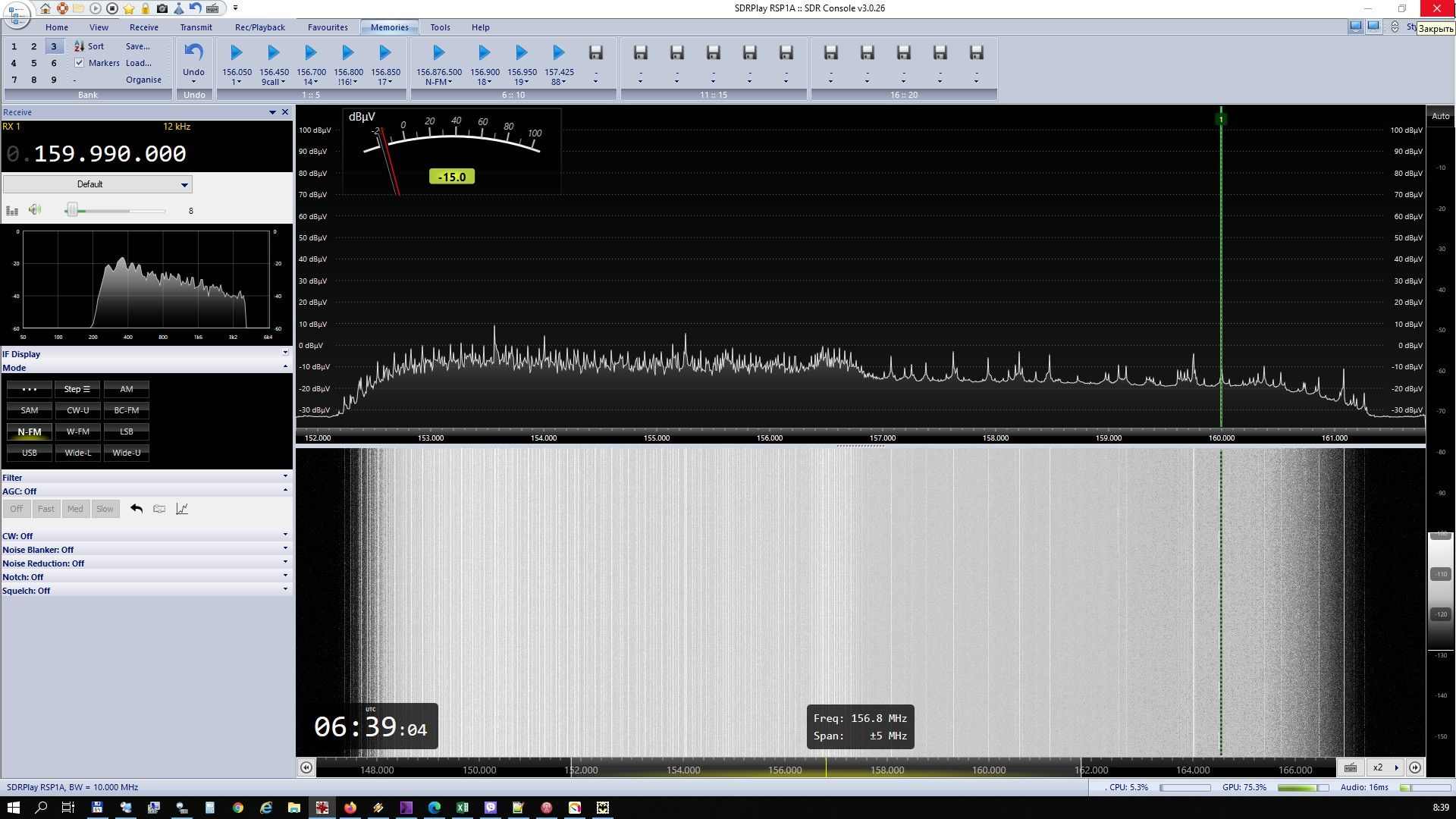

Good day! Installed SDR Console version 3.0.26 along with SDRPlay RSP1A on i9 7900x / 32GB RAM / SSD M2 + HDD / NVidio GT710 / Win2019 Server computer.
Everything started up and worked great!
This is my first experience with SDR, ... after viewing the menu, the recorded Markers are no longer displayed! Tell me what could have happened? and how to return the display of Markers.
no Markers
no Markers

That's what Ribbon menus do, eat screen real estate as if it was free. You can see "everything" with a smaller definition of "everything" if you go up to the top right. Going right to left you see a gear, the word "Style", and a double arrow symbol pointing up and down. Click on that and the ribbon stays down and the rest of the screen adapts to this.
Ribbons sacrifice utility for appearance. That's usually a bad trade as I see it.

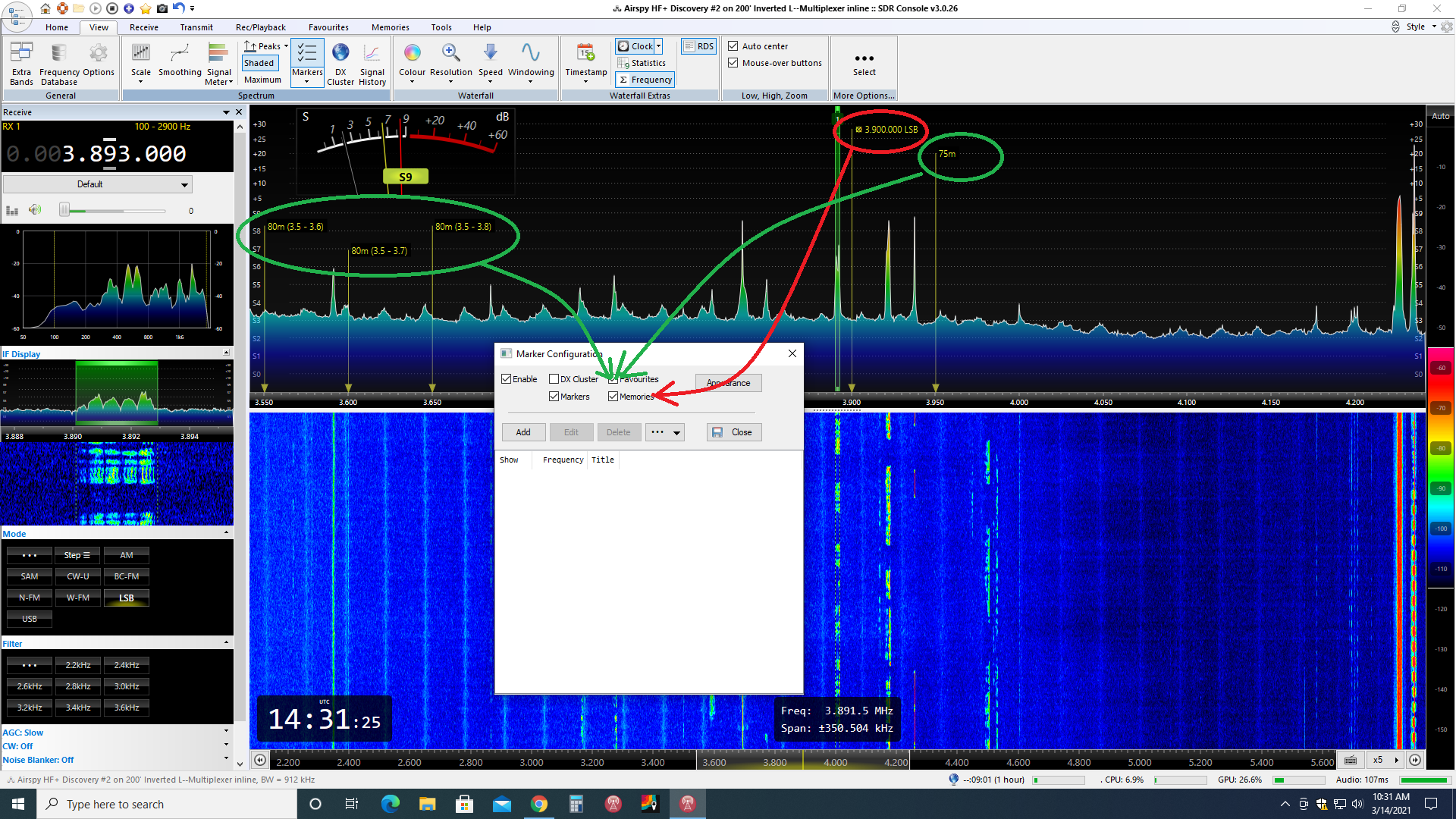

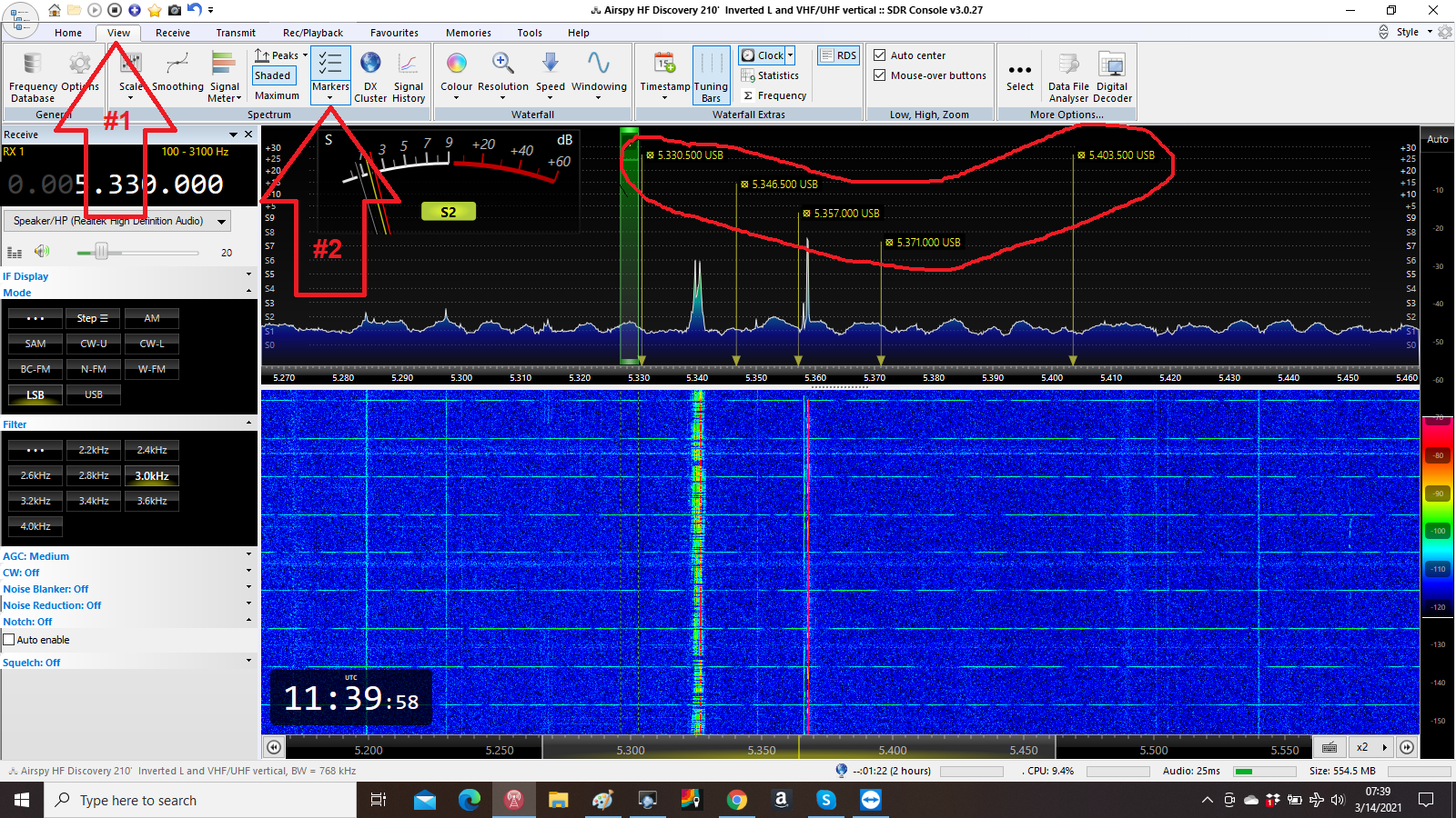

Hello VDA,
Are these the 'markers' that you are speaking of? They are turned off/on by a left click of the mouse on the top half of the 'Markers' button from the "View" tab of items. The button will turn a light blue, which can be easily missed. Currently where I am located in the HF spectrum, I have the 60M band channels marked for quick ID of ham signals versus other users of the band. Be sure to have them configured, (enabled and memories checked at a minimum) using the lower half of the 'Markers' button!
See image for the two step process, in order to see your markers.

Posts: 366
Re: SDR Console does not show markers
You need some memories saved in order to see them when toggled on. What does your config look like? My photo shows what markers are which while in 75M
