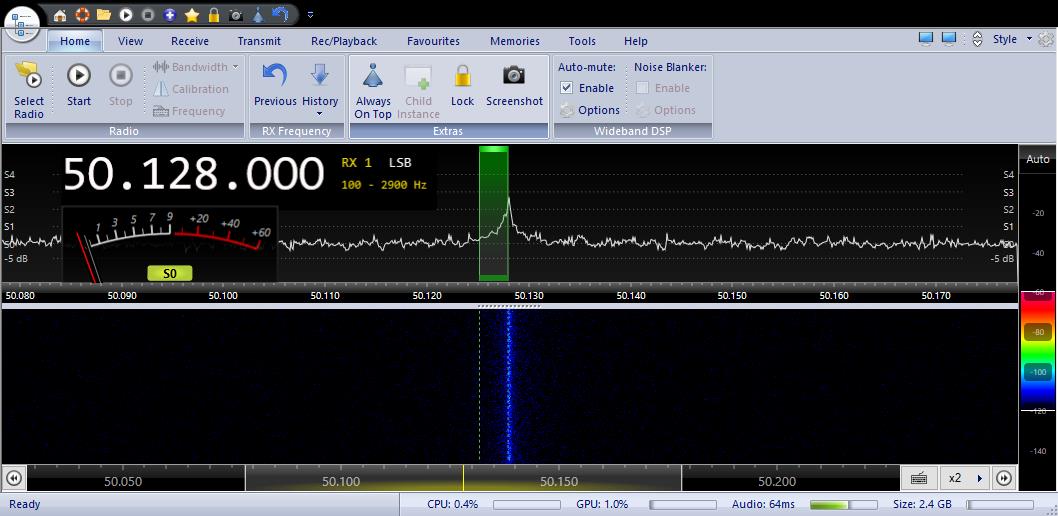

apologies if I'm not right here. Maybe somene can help me out. In SDR-Console I always have a noisy peak in the center no matter where I go (frequency, band...). Unfortunately I didn't find a possibility to get rid of it.
In Cubic SDR the peak is not there but SDR-Console fits better to my requirements.... if that peak weren't there...! :(
Anybody knows how to get rid of it?

Please add a screenshot.

@G4ELI & Max: Also many thanks to you guys! :) I now add a screenshot.....

Re: SDR-Console Peak in center
This way we can't see what bandwith your using... please add screenshots of a running radio.
Try a BW of 2MHz or lower... ;)
Show all the windows so we know your gain settings and so forth.
More Than You Probably Want To Know But Less Than Rigorous
With SDRConsole around here the presence of the noise spike in the middle is a really good indication I need to increase the front end's gain. Tune in a fairly weak signal. Increase front end gain. If the signal lifts out of the noise (SNR improves) repeat until the noise and signal lift by the same amount. if the signal gets very large compared to the noise move to a weaker signal. Repeat this until the noise and signal lift by the same amount. As a general rule I then back off one gain step if the steps are fairly small. By the time this dynamic range setup is done I'd expect that noise pip to be very much smaller.
There is a way to reduce it further. But it introduces a discontinuity in your tuning range at the notched out "DC" peak. That peak is basically made up of noise multiplied by a copy of eh same noise, local oscillator self-conversion, once the basic balancing act is performed.
Devices that use one single A/D converter for both I and Q signals by sampling at twice the intended I/Q sample rate are inherently balanced for all but the zero point with some slight imbalance from internal stray signals. Zero point balance is easy to achieve. Devices that use two separate A/D converters have many balance terms to setup. There is the same zero point balance times two. Both A/D converters must be balanced out. The A/D converter gain differences must be balanced out. And the 90 degree sampling phase shift must be balanced out. The gain differences are also easy to balance out in SW. Gain and offset form the center pip. Then you have the difficult balancing act, phase. If the sampling phase is not precisely 45 degrees within small fractions of a degree you get ghost signals for strong signals. The ghost signals are precisely as far from the center pip as the strong signal but on the other side of the pip. That requires some sophisticated auto-correlation nulling tricks. SDRSharp and Linrad do this. I am pretty sure Simon plays with that somewhere in SDRConsole but don't know for sure.
