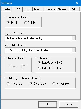

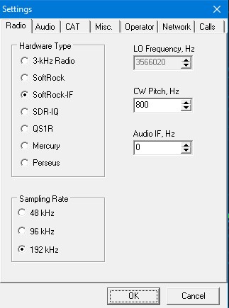

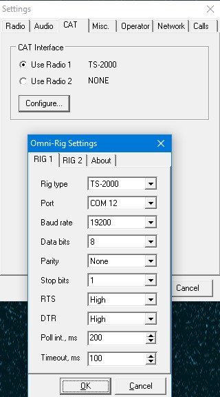

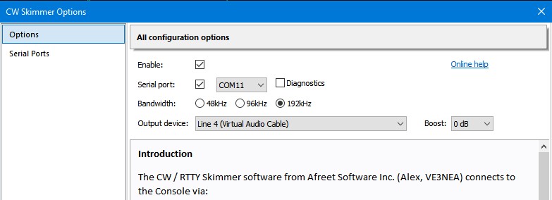

I just found these screengrabs of my settings I made before I transferred computers (see attached images). I don't know if any use? For sure CW Skimmer worked 100% fine with these settings on my setup. Radio is Hermes Lite 2 SDR.
Good luck.

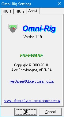

I don't think that your issue is anything to do with the VAC. You say signal arrives fine with CWS. Must be COM/Omnirig issue surely?
You should NOT use Omnirig, latest version. I believe it has many problem issues/incompatibilities.
You need Omnirig 1.2:
http://www.dxatlas.com/OmniRig/
I have SDR Console serial port working perfectly with many other programs. N1MM+, Log4OM, CWS, CSVUB, etc. etc. etc.
Don't use any other version of Omnirig. Could that be the issue?
Actually I seem to be running 1.19 but it works just fine.
