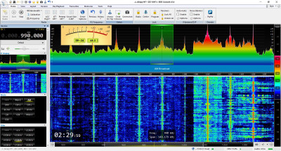

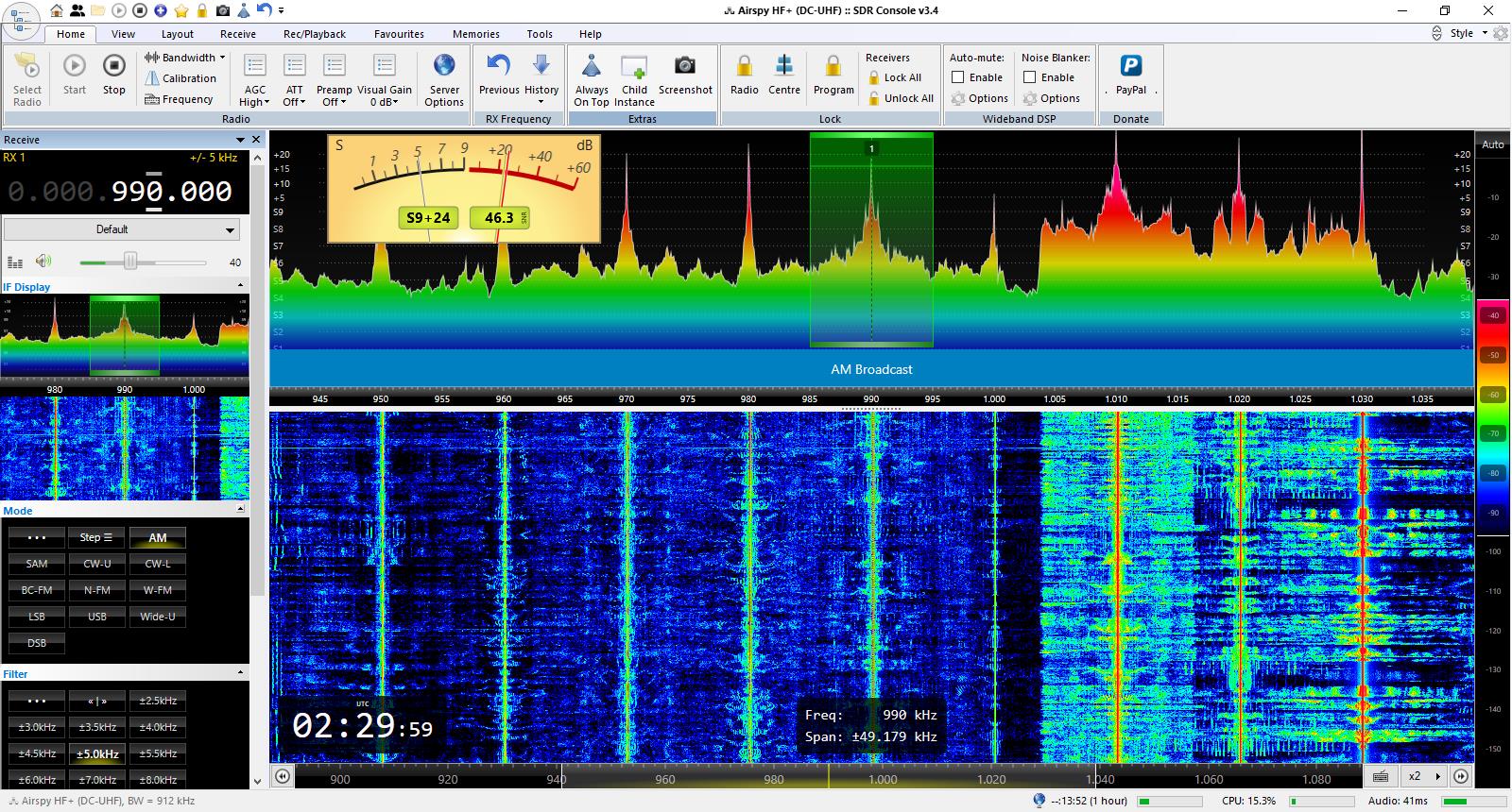

First, for FM broadcast, you need to be in the FM BC mode (FM Broadcast) for optimum filter width. There are a few FM modes with SDRC, FM Narrow, FM Wide, and FM Broadcast.

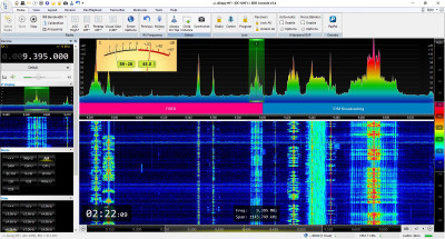

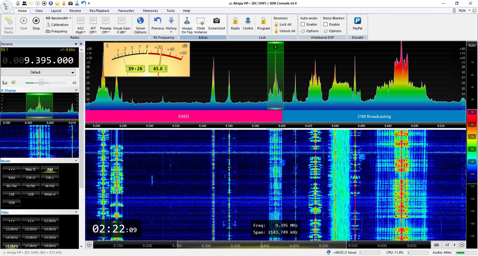

Also, be mindful of the frequency readout. As a sysop of 20 SDRs on 6 seperate SDRC Servers, I see newbee's struggle in reading the frequency. See attached image of 99.5MHz and how it's displayed in the frequency window of the DSP. I see folks thinking they're monitoring 14300kHz (Intercon/Maritime Mobile net) when they are really on 1.4300GHz.
It helps to know where the decimal place is when dealing with MHz! You can also place the mouse anywhere in the waterfall or bandscope and just start typing a frequency. Or, using a scrolling type mouse, hover over the frequency digit you wish to change in the DSP window and scroll... or left click on the bar above or below the digit that appears to go up or down in frequency.
One photo is of 9395KHz, WRMI of Lake Okeechobee, FL USA with good music after 0200z along with 5050, 5085, 5095KHz.
Another photo is of 990kHz WDCX of Rochester, NY USA
All images are just showing what the frequency looks like in the DSP window properly.
990AM WDCX Rochester, NY USA
WRMI 9395kHz from Lake Okeechobee, FL USA

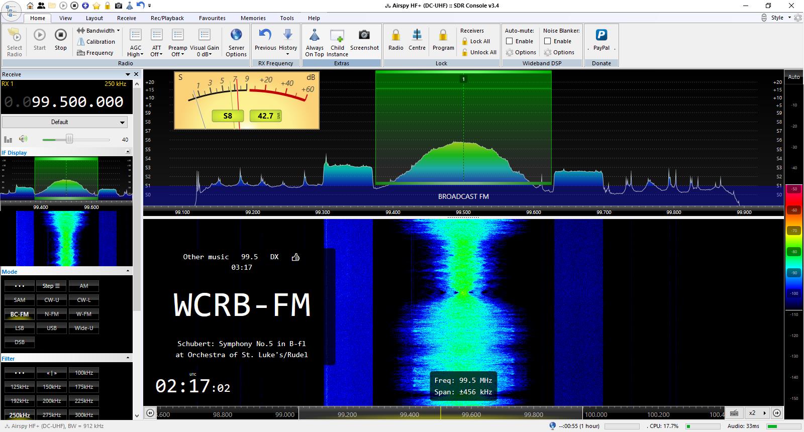

SDR Console on FM Broadcast WCRB Boston, MA USA

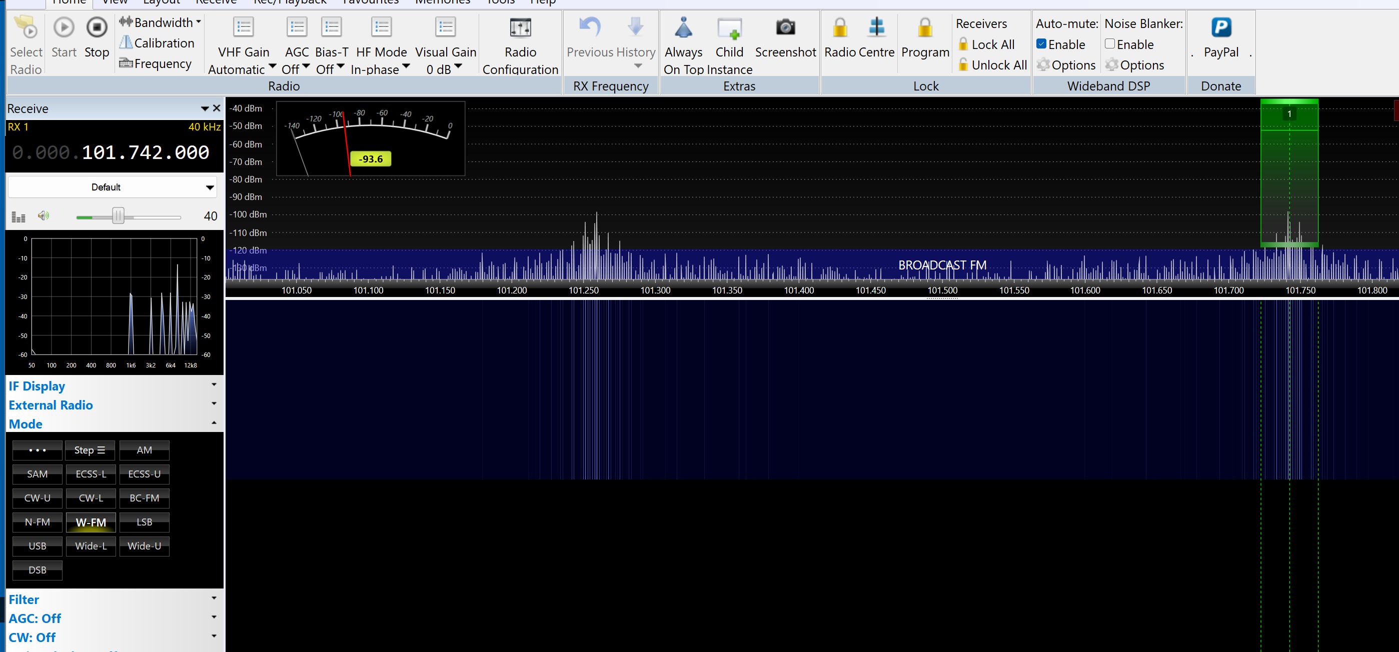

Weird, now I am just getting a high pitched tone, here is a screenshot:
Posts: 1044
Re: where should I post
Ah, as I see the picture it looks like the edges, title bar and status bar in particular, have been trimmed off. They contain a lot of helpful information. Some stuff you may need to write down. For a rough start set the "AGC" to either off or a number around 19. The VHF AGC might also have numbers that can be selected. The "Radio Configuration" panel pages might be interesting. It has been WAY WAY WAY too long since I used an E4000 based dongle. And I do not know what Simon has hooked up for rtlsdr dongles in general and E4000 based dongles in particular. So we may have to guess. At a guess the RF gain is set way low - or you do not have an antenna connected.

Since no call sign or other clue was given as to where you are located, here in the USA, broadcast FM are on odd tenths of a MHz, ie 99.5, 100.3, 101,1, 107.1MHz, so you will need to center your tuning accordingly. You were centered on 107.42MHz on a very narrow bandwidth... so yes, it would have sounded like crap! It's best to RX wide signals such as broadcast FM closer to the center, if the filter is on or near the edge, the signal can take a drop in strength.

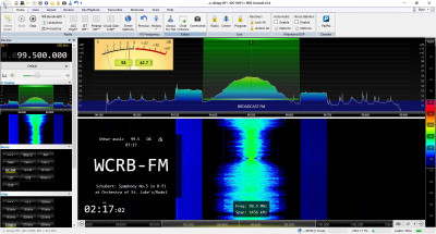

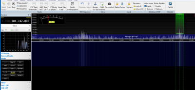

One thing that stands out is you are not in Broadcast FM mode (BC-FM) (See attachments). Your DSP panel says you have W-FM selected, which is only 40kHz wide. When you select BC-FM, it will default to 250kHz! I have attached two images (BC-FM3.png) and (W-FM.png) to show you just how wide BC-FM is. The sound with amplified PC speakers and subwoofer are awesome.
Left click on the three dots and add BC-FM to your list of choices (BC-FM.png), while there, you can remove those you will probably never use (ECSS-U, ECSS-L, Wide L, Wide U). I use DSB to calibrate the SDR's frequency via WWV, so you may want to keep that one. This will free up some space in the DSP window for the AGC, Filters, NR, NB, Squelches, etc. (BC-FM2.png)

W-FM selected sounds terrible, too narrow bandwidth!!
Properly received broadcast FM station
BC-FM Mode selected.
Click on the three dots to add/remove modes.
