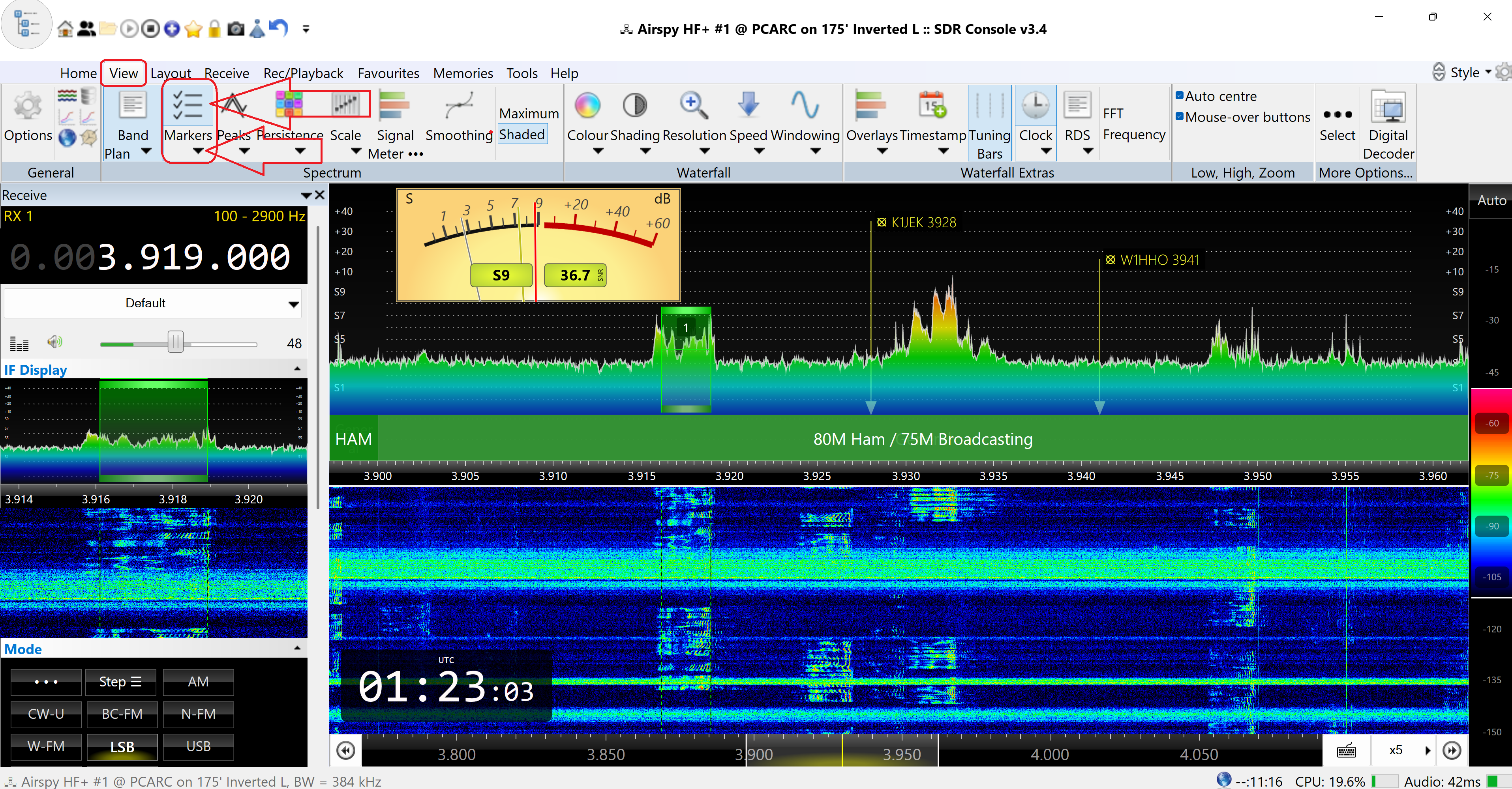

Tim,
Place your frequencies desired into memories, then edit the memory title to what you want (ie call and freq such as "KA1GJU 3928"
Then in the "ribbon bar", toggle the marker to on (hard to see but the three checkmarks and lines are highlighted in blue). By default, memories are marked, but you can press the "Markers" with the down arrow and configure what you want seen on the screen.

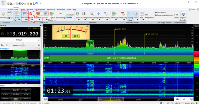

Re: Feature Question: User-Defined callsign Makers on the Panadapter
Or,
Ribbon bar, View, Spectrum, Markers?

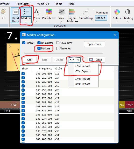

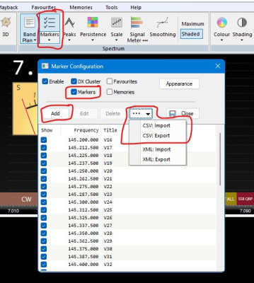

Yes, just add Markers either manually or via a .csv file. They appear on the spectrum exactly as per the DX Cluster spots.
