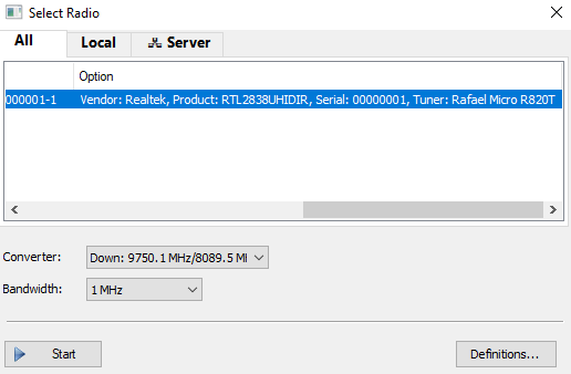

I have latest version of sdr console right now on windows 10 64 bit.
is the rtl-sdr model I am using.

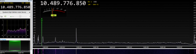

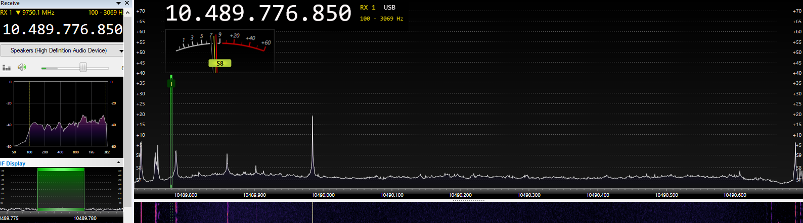

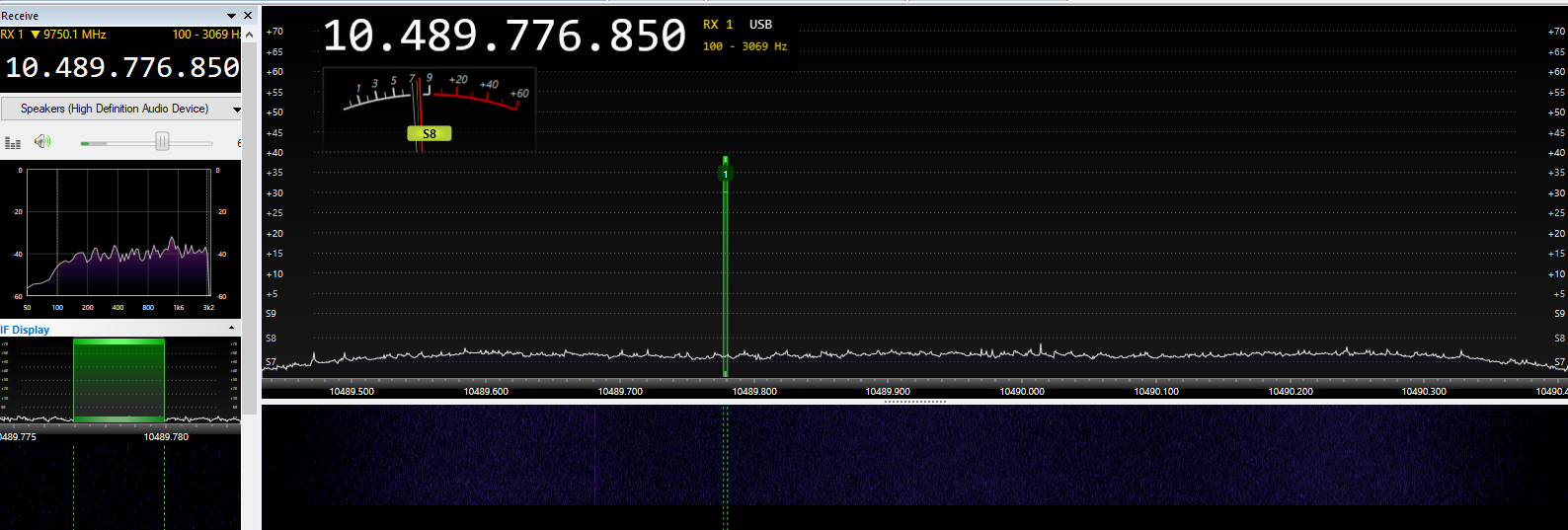

When I start this sdr with the offset needed for the oscar 100 satellite.. I have nothing but the white noise as you can see on the following screenshot.

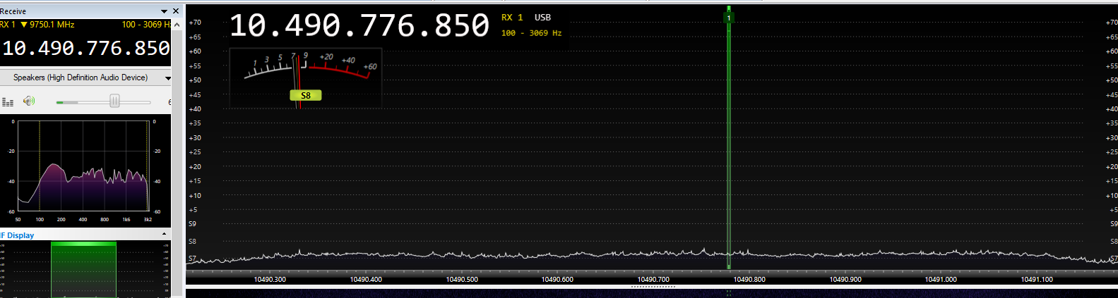

If I change the frequency up a digit as seem in here
and then just move back to the beginning frequency,
rtl starts to receive.
