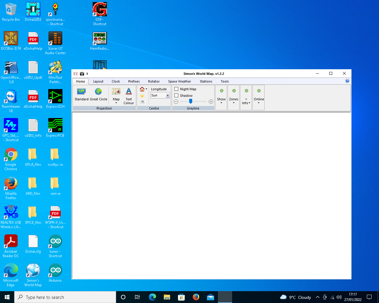

I would be grateful for any pointers please. After several downloads I cannot get Simons world map to run. I get the initial screen with no map for a few seconds then it disappears.

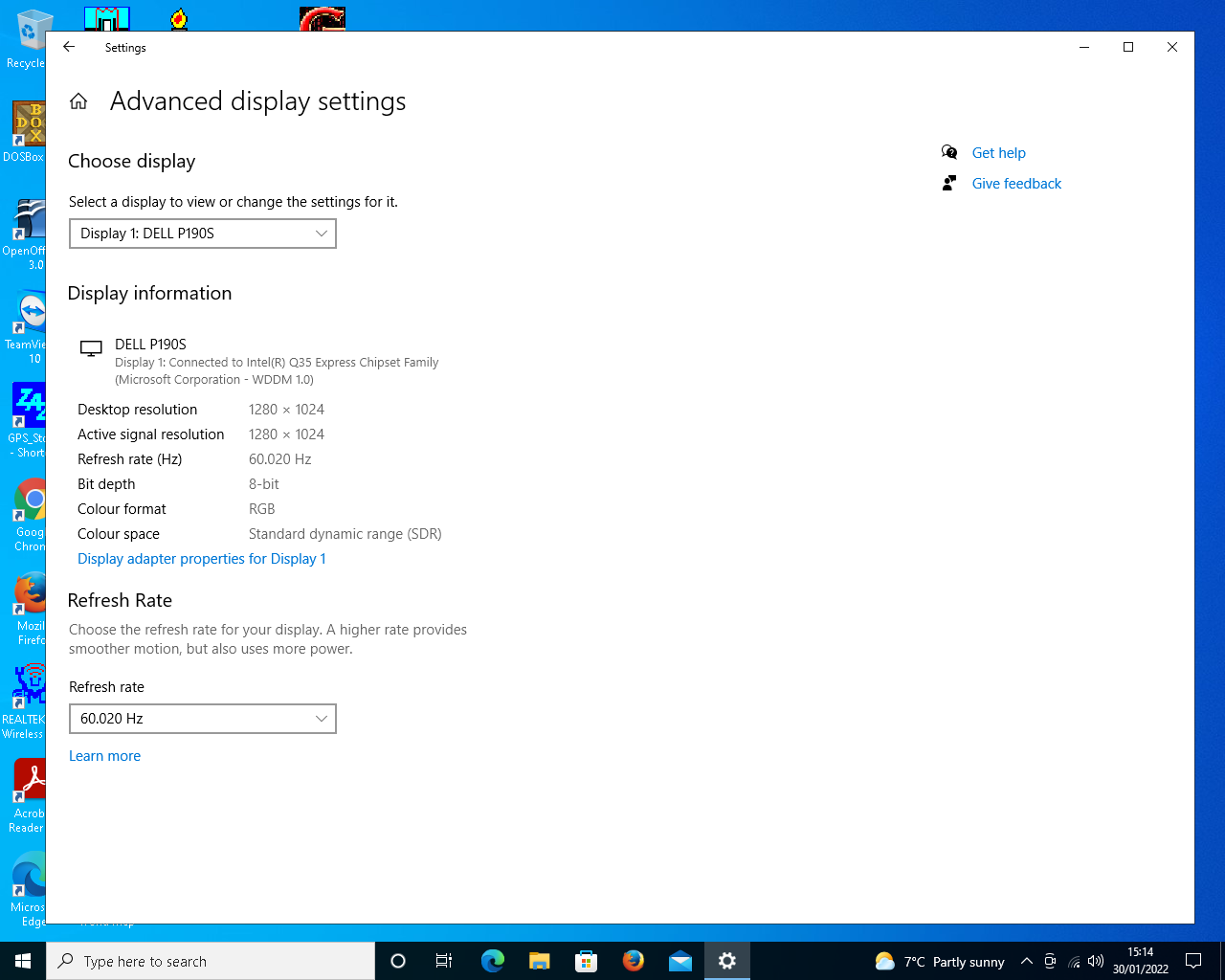

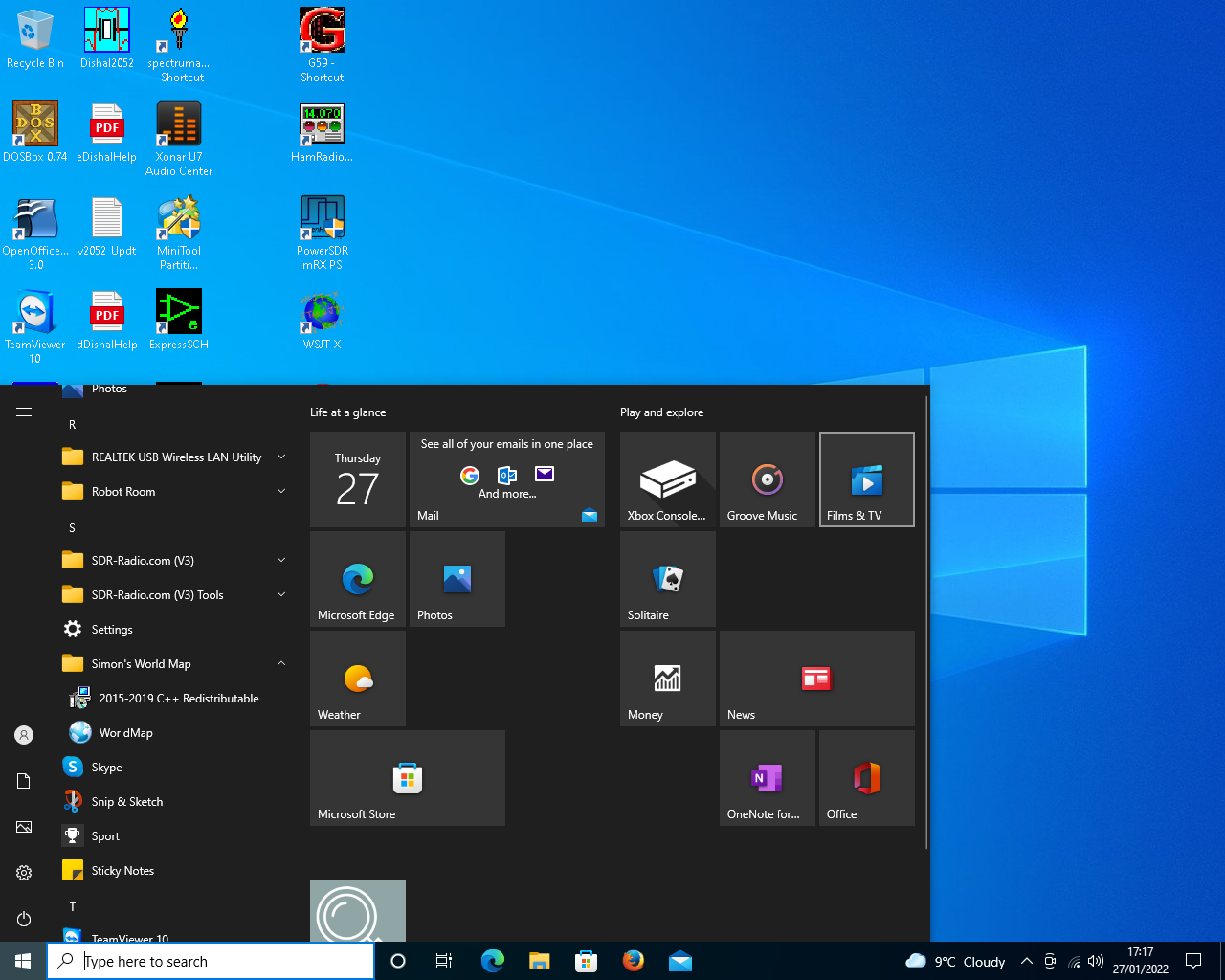

I hope the screenshots help.

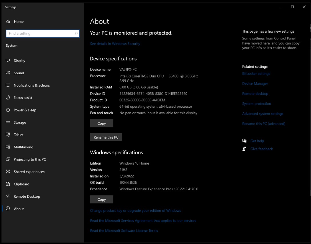

My system:
Dell Duo CPU E8400, 3Ghz
6 GB Ram
Win10 Home 21H2, OS Build: 19044.1526
Experience: Windows Features Experience Pack 120.2212.4170.0

- Posts: 2174
Re: Simons world map wont run
From Control Panel select System and show me this.
Also I'll add BugTrap so you can forward crash dumps.
