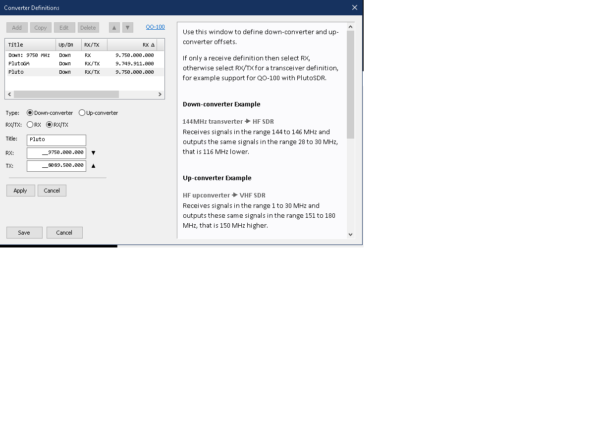

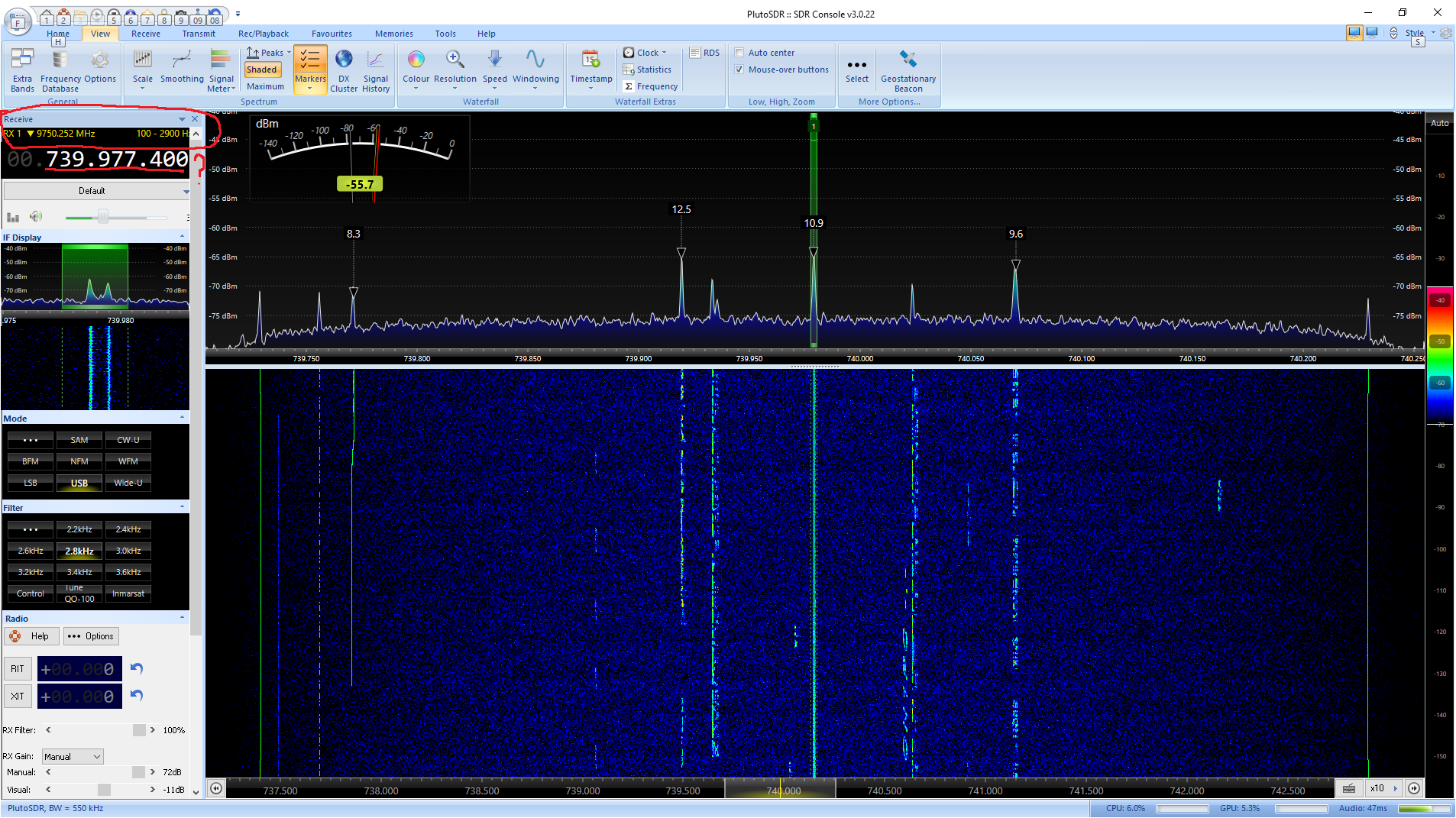

Thank you for your reply!! I've done it all, but it doesn't work out for me. In the attachment is a screenshot from my console. The color indicates that the converter is enabled with the required spacing... What am I doing wrong??
Posts: 1071
Re: Please help me
Not sure if it's related (probably not), but you are running very outdated version of SDR Console. Current is 3.0.27:
Posts: 1071
Re: Please help me
Did not realise you had two post topics on the go. I see you are now sorted, but I'd still update to latest 3.0.27.
