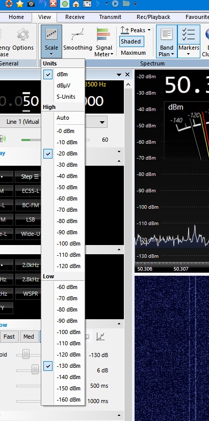

How can i change the dbm steps in Spectrum?
At the moment there are only 5db steps, i wwould like to change to 10db

I don't think there is an adjustment for that directly but can be achieved by manually setting high/low values for scale here (usually defaults to "auto"):

You can't, it's fixed as Max shows.

At Max s snapshot there are 10db steps.When i change the scale manually like Max, its still at 5db

Ah, that's probably a drawing algorithm.

Ah yes, I can see it changes as you click and drag the horizontal divider bar up and down between spectrum and waterfall.
