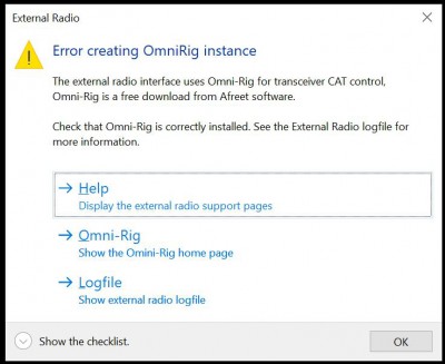

Can someone help me fix this issue? I have Omnirig v1.20 and version 2.1.0.0 installed in two different areas of my system
Thanks for your help.

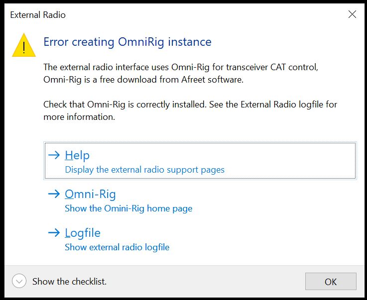

Error Creating Omnirig instance

Here is my error log if anyone can assess whats going wrong. Thanks!
