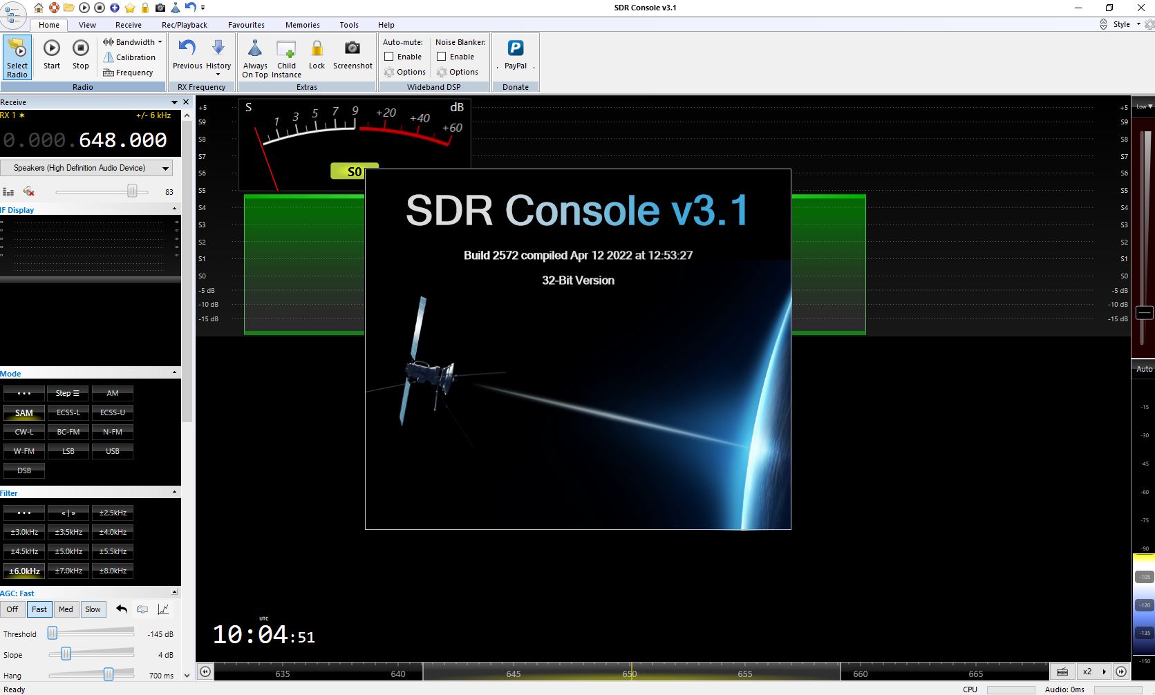

I've been using SDR Console for some years and taking the upgrades as they come in 32 bit. I operate Win10.
Recently my SDR Console simply will not startup correctly. I've attached a screenshot.
The "Select Radio" screen does not seem to want to pop up.
This even occurs without any USB SDR connection.
Any thoughts please.

As an update, I've just completely de-installed, restarted the PC, re-installed and the same occurs with SDR Console taking 29% CPU and 37MB memory (High) No Disk, No Network.
In recent days I've taken a standard MS update for Win10 32 bit. Could this be the issue.

On the downloads page, follow the instructions to reinstall the redistributable packs. Looks like it's stuck either loading the SDR DLLs or somewhere in that area.
Another thing you could do is to run DebugView: https://www.sdr-radio.com/diagnostics#DebugView as it may be spewing out errors.
Re: SDR Console - Does not startup
Just checked on a small 2GB W10 32-bit system - this also hangs, so will sort the problem out.
