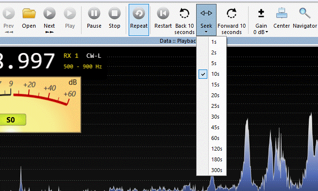

Hi Joerg. As nobody else has answered, AFAIK the persistence of this feature cannot be changed in any user settings. I think people looking for transients would do this by doing a data recording and analysing the data playback later? How, I'm not sure. I know you can skip quickly through a data playback in presetable "chunks" (see attached image).
https://www.sdr-radio.com/data-recording
