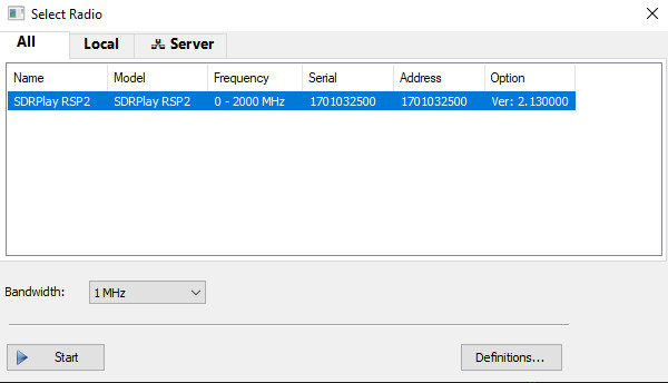

Can you please let us know. Did you press "Select Radio" and then add the RSP2 definitions to the list of radios? If you successfully managed to "Add" the RSP2 then there should be a line in the list of Radio Defintions thta looks like this (RSP2 highlighted)

If you do not see an entry like that, what do you see? Please send (attach only - not inserted picture) a screenshot.

Here is the attached list you requested.

On a lark try rebuilding the rsp2 definition. Old definitions may not be supported in V3.3 et subs. You mention "sdrsourcesdrplayv3.dll" while the definition declares V2.1.
